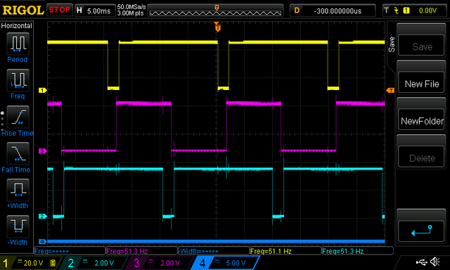

I've been polishing up the ignition code. The finished code will have a "watchdog timer" that will reset the CPU within 5 mSec should it lose it's way for some unknown reason. There will also be an R/C constant on one of the spare I/O pins to allow for a warm boot (no CRC of the code segment) if the watch dog triggers. I don't think there is a good way to prevent a bad timing pulse if the watchdog triggers, but I want to ensure that there is no bad timing pulse when the system restarts. Before leaving the ignition code (for now) I simulated a watchdog event by tapping the reset button.
Each edge of the center trace represents a blade. The system is initialized to eEngineStopped state with the ignition coils de-energized. If both blades are seen within 2 seconds, the eEngineCranking state is entered and the ignition coils are energized. Once two blades are seen on the same channel and the RPM is greater than 650, eEngineRunning state is entered. During engine cranking, the coils are fired TDC. In this example during engine running the coils are fired 45 Deg advanced. As you can see, the system first fires on the third blade after reset. That occurred at TDC as the system spent one blade in the cranking state. Subsequent ignitions occurred at 45 Deg. advance. No bad pulses. Good enough for now. On to injection.

Postby WesRagle » Tue May 04, 2021 10:31 am
Hi Guys,
I've pretty much beat ignition pulses to death. (Ref. https://sonexbuilders.net/viewtopic.php?f=66&t=6203#p47024).
The real focus of this project is fuel injection. But, since I intend to use my existing ignition system to time fuel injection I couldn't resist adding ignition control.
The anticipated benefits of ignition control are:
1) Reduced current consumption during ground operations.
I intend to use 5 Ohm coils and control dwell to reduce current consumption at low RPM. At present the ignition pulse widths are controlled by two hard coded constants. MAX_DWELL = 25 mSec and MIN_BURN = 2 mSec. At low speeds MAX_DWELL dominates, at higher speeds MIN_BURN dominates. Again, the center trace is the simulated input, the top and bottom traces are the ignition pulses going to the forward and rear ignition coils (28 Deg. BTDC).
A pic of what works out to be 984 RPM with MAX_DWELL dominating.
A pic of what works out to be 3078 RPM with MIN_BURN dominating.
Hopefully I reduce the ignition current enough to cover the fuel pump and injector current during ground ops.
