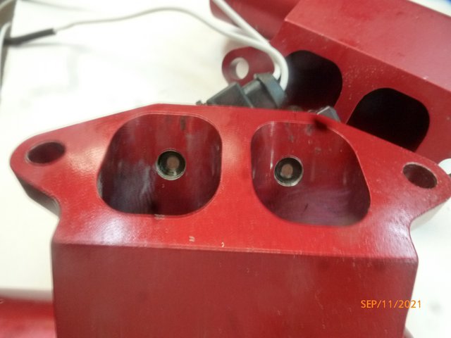

For those that don't know, here is how I installed the injectors for development work. They are cheap Chinese injectors, intended for motorcycles I think, but they are sufficient for their purpose. In any event, pretty much a direct shot at the intake port.
One of the primary reasons I wanted fuel injection on my VW is to protect my rear cylinder exhaust valves. My rear cylinders always lean out under high power causing me to have to reduce power, risk burning my rear cylinder exhaust valves, or run so rich on takeoff that power is again down. So, fuel balance is top of my priorities for fuel injection.

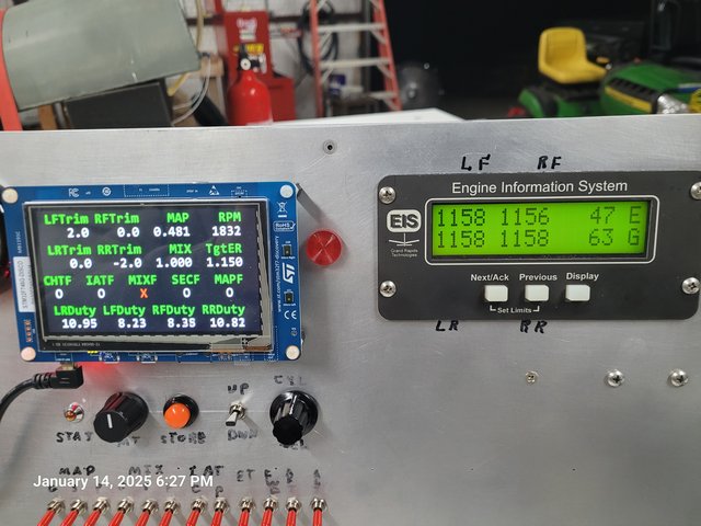

I was fooling around today with the new Balance method and took a couple of pics.
Just because I can :) You will notice the trim numbers sum to zero. Also notice that it didn't take much trim to match up the EGTs.

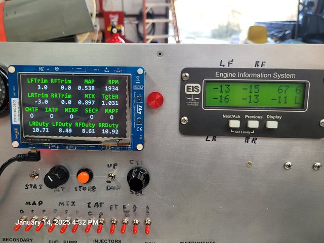

Until yesterday, I had never played with the leaning functions of the EIS. This pic shows the peak EGT spread lean of peak.
With the balance method described above it's easy to get the "Gami Trim" to near zero. Just lean until the first cylinder peaks, click on that cylinder to add fuel, and carry on in a similar manner until all cylinders have peaked.
The reason that it didn't take much trim to balance the EGTs in the previous pic is because the EGTs were balanced during engine calibration, at each calibration point, and the trim numbers saved as part of the calibration. In normal operation those trims numbers are interpolated keeping the EGTs balanced over the full RPM range. You might also notice the Duty Cycle difference on the last line of the display to see how much imbalance there was that is compensated for by the calibration data.
