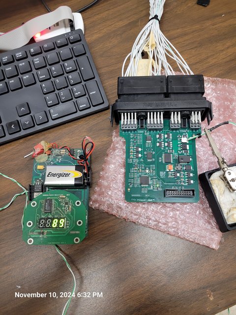

Hi Guys,
Lots of distractions lately but ..., some progress.
I ported the software from the bread board to the prototype. I hooked up the prototype to Frankenpanel.
Frankenpanel allows me to drive either LEDs, for software development, or actual coils and injectors, for hardware testing.

I received the thermal conductive glue. A long time ago a guy showed me a method for measuring the temperature of an IC. First you get some high quality TC hookup wire. Then form a TC by stripping the wire and clipping off all but one strand of the wire. Next, twist the two strands together tightly and clip off all but the very tip. Put some thermally conductive "stuff" on the IC in question and stick the tip of the wire into it all the way to the surface of the IC. Make sure the strands do not touch outside the thermally conductive stuff.
That's all there is to it. A very responsive TC with very little heat sink effect.
I have an old EGT prototype gauge that I rescued from the trash after a lab clean up at work some 25 years ago. Still works and is very accurate.
To test the ignition transistor temperature rise I decided to go for broke. I hooked up a 3 Ohm Dynatek coil and set the RPMs to 60. At 60 RPM no dwell control is applied/possible so the coil is powered virtually 100% of the time. I intend to rate the VeeCU for operation over a voltage range of 6 to 20 volts so I set the voltage to 20.
I got some results I didn't expect.

Postby WesRagle » Thu Nov 14, 2024 7:14 pm
Hey Robert,
WaiexB22 wrote: Maybe consider attaching a heat sink to the enclosure?
The ECU generates right at 1 Watt of waste power/heat per amp of injector/ignition drive.
If you are interested, here is the data sheet for the IGBT used: https://www.mouser.com/datasheet/2/308/1/FGD3245G2_F085_D-3150312.pdf
If you look at the graphs starting at the bottom of page four you can see that V(CE) is about 1 Volt at the current required by the ignition coils. Luckily decreasing as the part heats up. That's where the waist heat is generated. So, about 1 Watt per Amp. If you look at the current at high cruise with the 3 Ohm coil you'll see it's about 4 amps. So, only 4 Watts to dissipate.
The Design Engineer working on the project did an excellent job of placing a lot of copper around the IGBTs and the "Engine Control IC" to use the PCB to draw heat away from the high power parts. With the PCB lying open on the bench it only heats up 10 Deg. C. under heavy load. With the case on, add another 10 Deg. All of this to say that with the VeeCU mounted in the cabin there is no real need for extra heat sinking. The case gets slightly warm to the touch, but that's about it.
